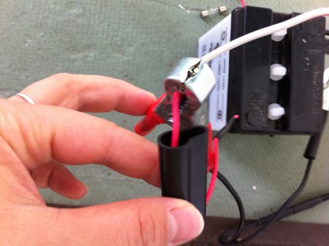

I am trying to charge up the battery but it might be gone. It is finally taking a charge now after I shook it up... Does anyone have a good rec for a sealed one that fit in that little spot? Is this the best place to put the + clamp when I charge it?

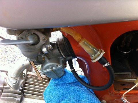

What is this little piece between the petcock and the carb? Does it look like it needs to be cleaned to you?

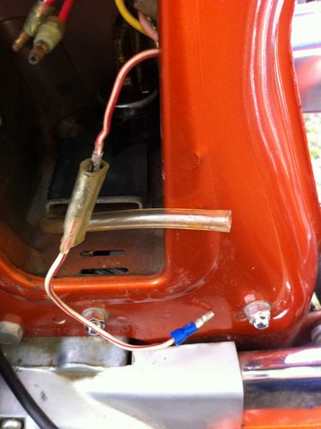

What does this red/white wire go to/is it important? I just put the battery in and kickstarted the bike and it worked (for about 2 seconds) w this one unattached.

You can measure your battery and look around on Ebay for a replacement that matches your size. Just grab any 6v battery as long as it fits you're good. Mine puts out some weak voltage from being a few years old but my bike still runs great. They hardly need any power to operate. Now if you want the lights to be nice and bright that's a whole other story. :D
